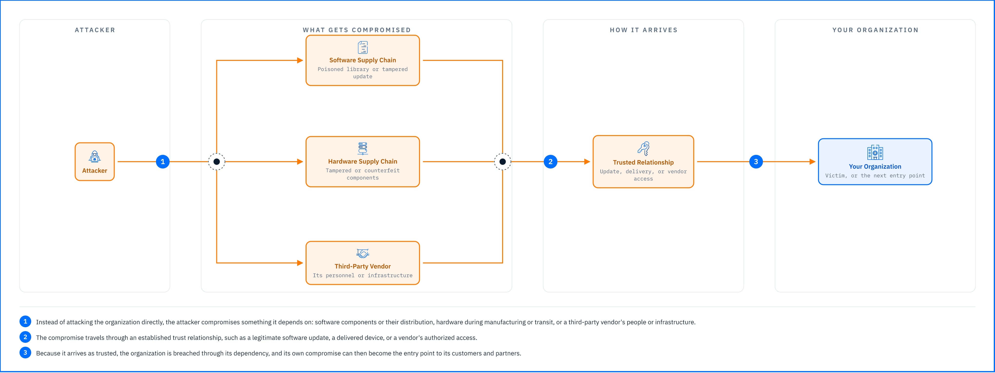

Understanding Supply Chain Attacks
Supply chain attacks are diverse, leveraging various methods to compromise an organization through its trusted external dependencies. These attacks can be categorized by their primary target and method of exploitation:
  • Software Supply Chain Attacks: Involve the compromise of software components or distribution mechanisms. Examples include the injection of malicious code into open-source libraries, or the tampering of software updates. Once compromised, the malicious software is then distributed to unsuspecting customers, leading to widespread infection.
  • Hardware Supply Chain Attacks: Involve tampered or counterfeit hardware introduced during manufacturing, transit, or distribution.
  • Compromise of Third-Party Vendor: Involve attacks that directly target external entities (vendors, service providers, partners, contractors) on which an organization relies, focusing on either their personnel or their operational infrastructure.
Fig. 1. Three types of supply chain attack, each reaching the organization through a trusted relationship

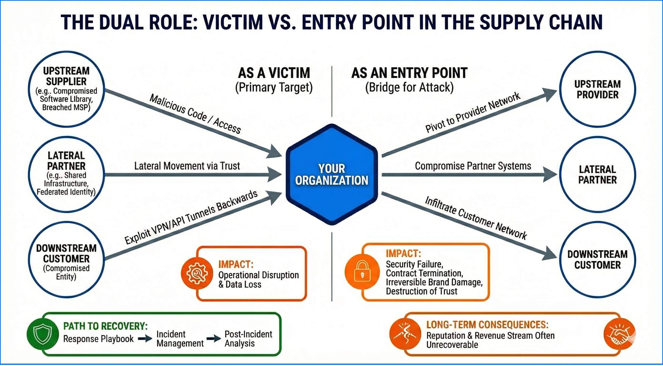

The Dual Role: Victim or Entry Point
In the supply chain, your organization never exists in a silo. It acts as an interconnected node that can serve as either a threat destination or the entry point to another entity. While these relationships are often viewed vertically (upstream/downstream), supply chains are complex ecosystems where threats also move laterally through partners, shared service integrations, or federated identities.
Fig. 2. An organization as a victim of, or entry point into, supply chain partners
As a Victim: Your organization is the primary target. The attack originates from an external entity within your ecosystem. While this is commonly an upstream supplier (e.g., a compromised software library or a breached MSP), it can also be a lateral partner with shared infrastructure or even a downstream entity (customer) that has been compromised to reach your environment—often by exploiting trusted communication channels or administrative access. For example, an attacker may compromise a downstream customer to exploit VPN support tunnels or abuse authorized API keys that connect back to your internal infrastructure. While the operational disruption and data loss can be significant, the path to recovery is often defined by a response playbook, incident management, recovery, and post-incident analysis.
As an Entry Point: Your organization becomes the bridge for an attack on another entity. Attackers exploit your vulnerabilities to pivot into the networks of your customers, partners, or even providers. In this scenario, you are the security failure that your customers' security teams warned their board about. For many organizations, this results in the permanent termination of key contracts and irreversible damage to the brand. If your business relies on a major partner, a breach facilitated by your systems doesn't just damage your data; it destroys the foundational trust required to do business. While a victim can recover their systems, an entry point may never recover their reputation or their revenue stream.

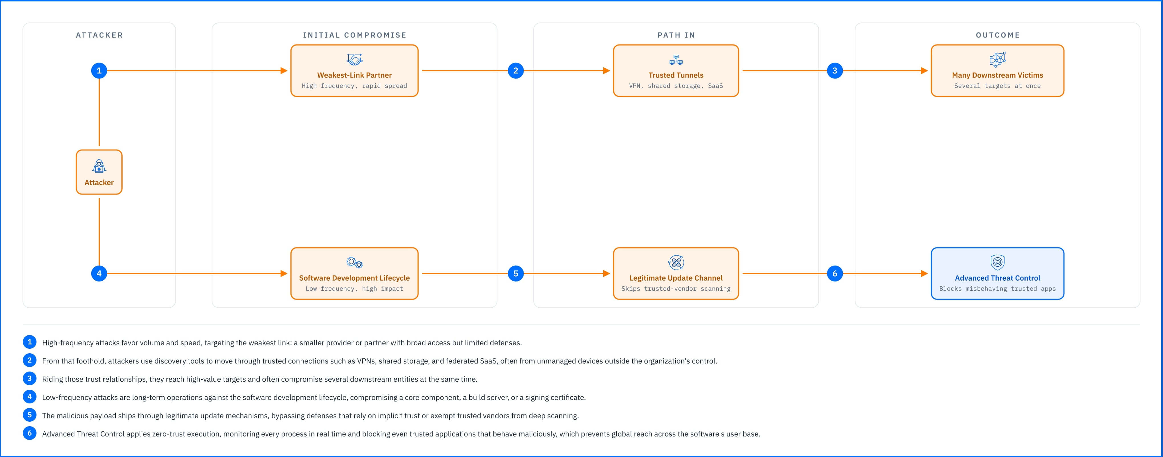

Supply Chain Attack Profiles
The impact of a successful supply chain attack frequently scales beyond the initial point of compromise, resulting in systemic operational failures and deep reputational damage. The technical profile of these incidents generally falls into two categories based on their movement and scale:
  • High-Frequency, Rapid-Lateral Movement Incidents: These attacks prioritize volume and speed, typically targeting the "weakest link" in the ecosystem—smaller service providers or partners with expansive access but limited defensive resources. Once an initial foothold is established, attackers leverage discovery tools to move laterally through trusted tunnels (VPNs, shared storage, or federated SaaS environments). By exploiting these established trust relationships, they utilize trusted connections—often originating from unmanaged devices that sit outside the organization's direct control—to move laterally into high-value targets, often compromising multiple downstream entities simultaneously.
  • Low-Frequency, High-Impact Software Compromises: These are sophisticated, long-term operations targeting the integrity of the software development lifecycle (SDLC). By compromising a single core component, a build server, or a signing certificate, attackers can inject malicious payloads into legitimate distribution channels. Because the malware is delivered via trusted update mechanisms, it bypasses traditional perimeter defenses that rely on implicit trust or vendor whitelisting. Many security solutions prioritize performance over security by exempting trusted vendors from deep scanning, creating a blind spot. In contrast, Bitdefender Advanced Threat Control (ATC) operates on a zero-trust execution model, monitoring all processes and their states in real-time. This ensures that even "trusted" applications are blocked if they exhibit malicious behavior, preventing immediate, global reach across the entire user base of the affected software.
Fig. 3. High-frequency lateral spread compared with low-frequency software lifecycle compromise

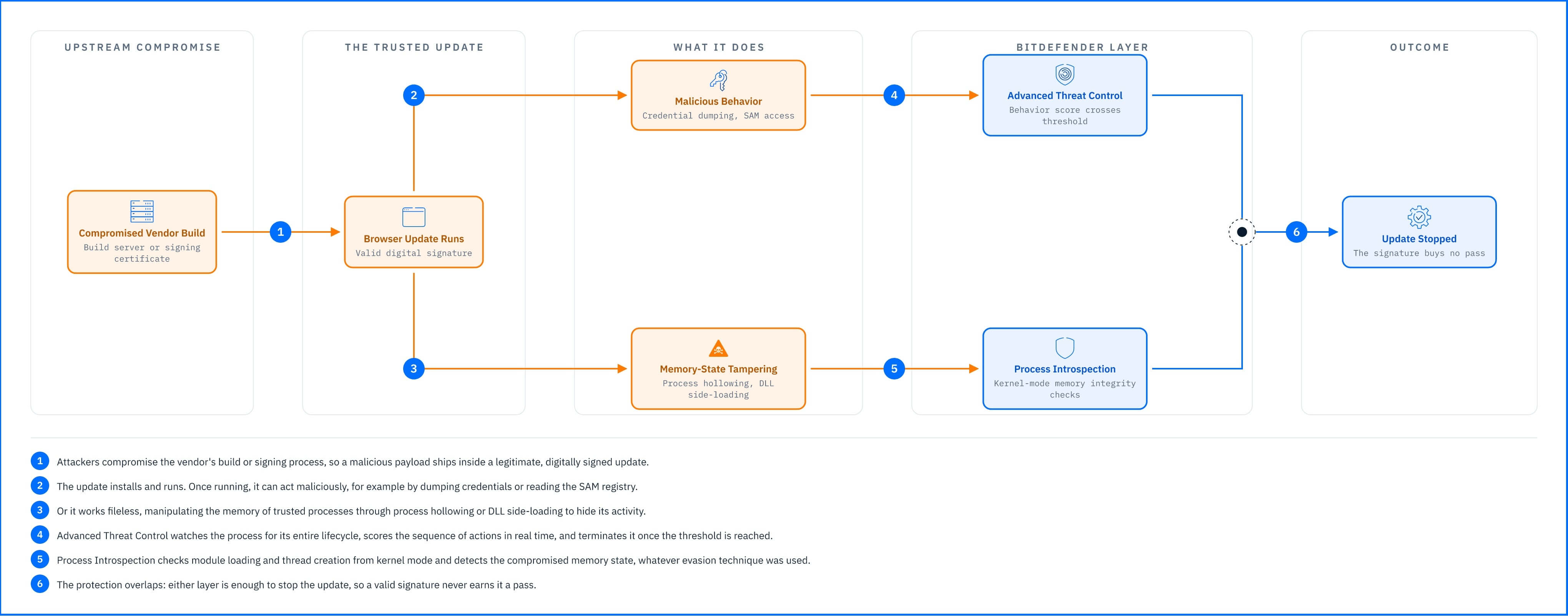

Traditional security relies on "signed" software and "trusted" vendors. However, supply chain attacks prove that even legitimate, digitally signed updates can carry malicious payloads. Safeguarding the upstream chain requires a transition from identity-based trust to behavior-based verification, implementing Zero Trust at the process level. We must assume that any piece of software—regardless of its origin—could be compromised before it reaches the endpoint. As established in earlier sections, many security solutions prioritize performance over security by exempting trusted vendors from deep scanning, creating a critical blind spot. To close this gap, organizations must implement rigorous, non-discriminatory validation that treats all incoming traffic and artifacts as potentially hostile until proven otherwise by their operational behavior.
Advanced Threat Control (ATC) provides the necessary layer of constant suspicion. It does not stop its inspection once a program starts; instead, it monitors the process for its entire lifecycle, treating every "trusted" update as if it were on a permanent probationary period. Utilizing over 300 heuristics and real-time machine learning, ATC tracks the sequence of events—every system call, API interaction, and file change. If a legitimate application suddenly begins to exhibit anomalous behavioral patterns—such as SAM registry dumping, suspicious credential access, or unauthorized process injection—ATC identifies the risk immediately. By assigning a behavioral probability score to these actions in real-time and terminating the process once a threshold is reached, ATC ensures that a compromised vendor update cannot hide behind a valid digital signature.
Due to its deep telemetry, ATC is frequently the core technology utilized in Bitdefender security advisories to document zero-day exploits and high-profile supply chain attacks. This telemetry provides the forensic depth required to deconstruct complex attack chains, which are regularly shared with the security community via the Ctrl-Alt-DECODE (you can subscribe for technical deep-dives).
True resilience requires looking even deeper than the operating system. Process Introspection (PI) provides deep protection by monitoring memory-state changes and key process operations from a low-level perspective. Many supply chain attacks use "fileless" methods to avoid detection, attempting to hide their movements by manipulating the memory of trusted programs via techniques like process hollowing or DLL side-loading. Process Introspection identifies these "turncoat" processes by applying advanced security checks during module loading and thread creation. Because it operates primarily in kernel mode, PI is resilient against user-mode evasion techniques like DLL unhooking. It detects when a program tries to subvert its own memory space or inject malicious instructions into another process, even if the malware manages to gain administrative rights.
To illustrate this synergy: in the event of a compromised browser update, ATC monitors the resulting sequence of events and terminates the process if it initiates malicious actions like unauthorized credential dumping. Simultaneously, PI monitors the internal integrity of the process to detect malicious state changes—such as process hollowing—regardless of the specific evasion technique employed. The result is overlapping protection, ATC neutralizes the threat based on its malicious behavior, while PI stops it because the underlying memory state has been compromised. This combination ensures that "trusted" software remains truly safe.
Fig. 4. Advanced Threat Control and Process Introspection stopping a compromised, signed update

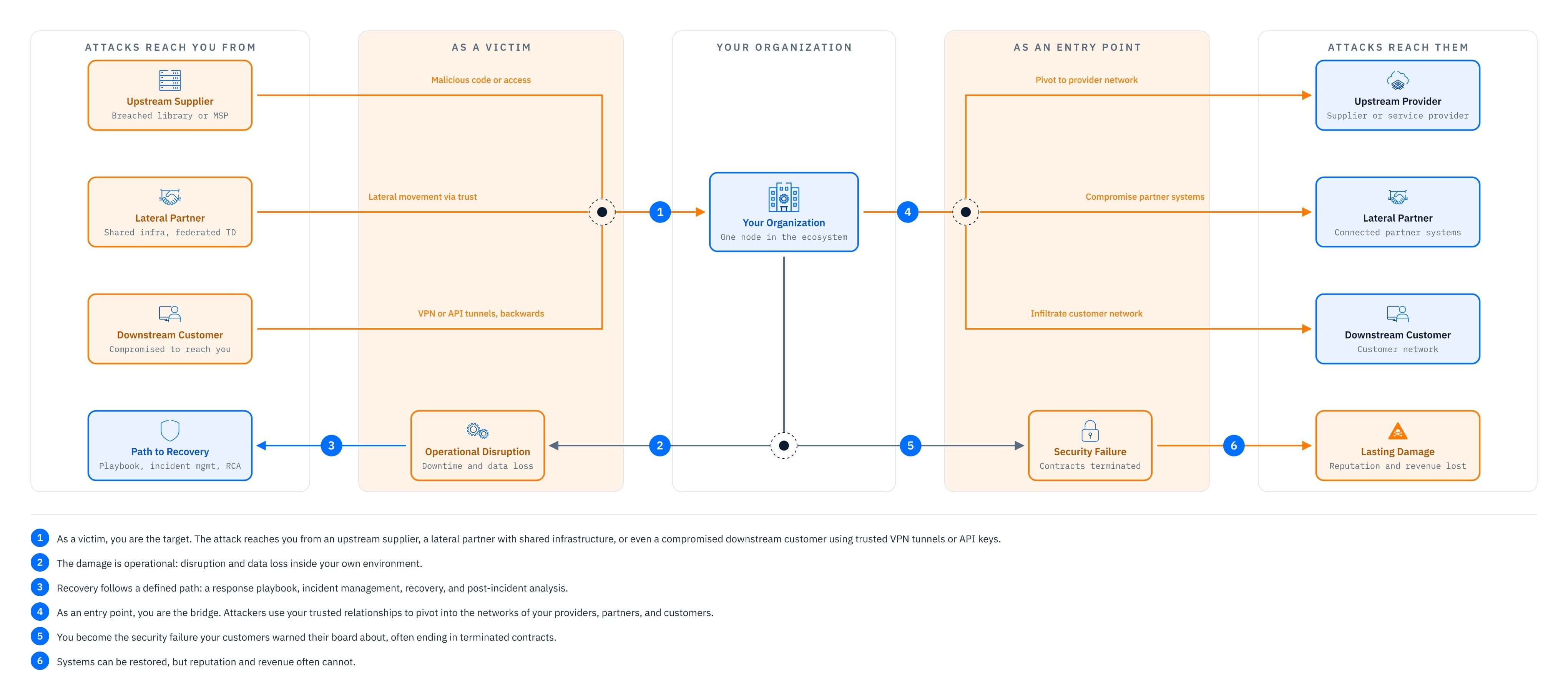

Securing the Connected Business Ecosystem and Third-Party Interactions
Beyond software, the supply chain includes the human and operational infrastructure of third-party vendors. Attackers often bypass hardened perimeters by targeting the "side doors" provided to contractors or service providers. The primary danger of such a breach is the "Day Zero" invisibility of the adversary; because they enter through verified channels—such as Site-to-Site VPNs or administrative portals—they appear as legitimate technicians performing authorized tasks. In this scenario, the supply chain compromise acts as a specialized tactic to gain an initial foothold, where post-exploitation steps—such as internal reconnaissance and privilege escalation—are masked by authorized access. Because static identity checks alone cannot differentiate between a valid user and a threat actor inheriting this level of trust, transitioning to continuous behavioral monitoring is the only viable defense to detect subtle deviations from established baselines.

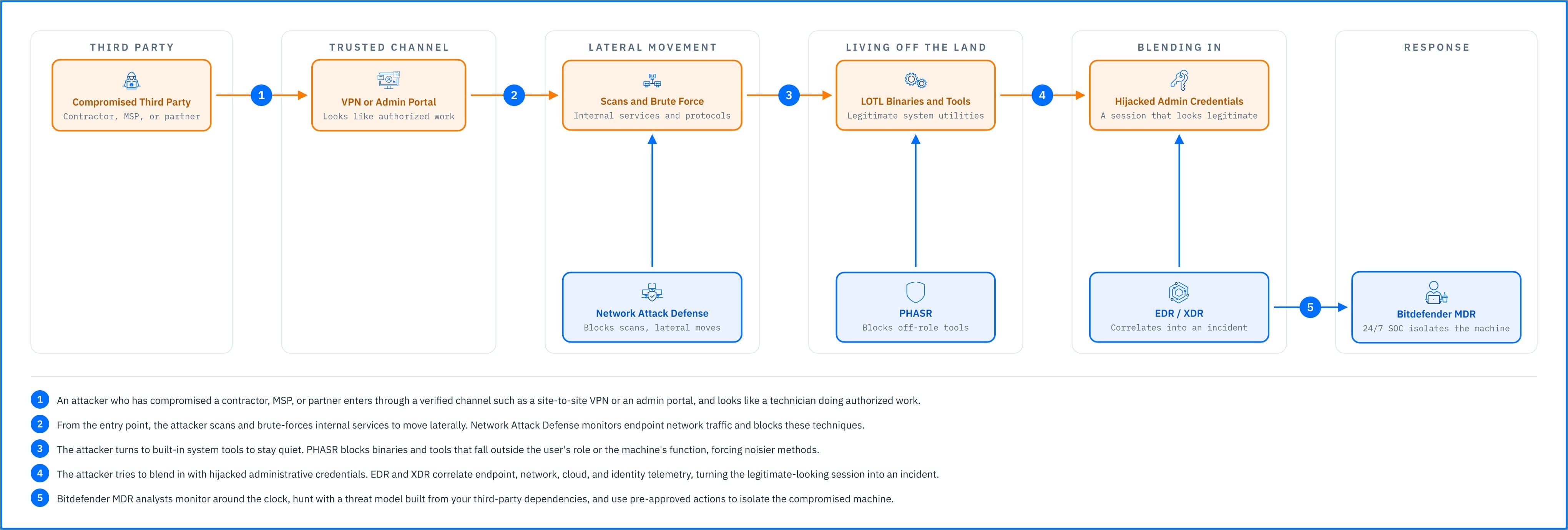

When an attacker leverages a trusted tunnel to enter the environment, their next objective is lateral movement. Bitdefender Network Attack Defense provides a critical layer of visibility into this phase. By monitoring endpoint-level network traffic, it can discover and block scans and lateral-movement techniques—such as brute-force attempts on internal services or exploitation of network protocols—that an adversary uses once they pivot from the initial entry point.
To further complicate an attacker's movement, organizations must systematically shrink the internal attack surface by neutralizing the tools adversaries rely on. Proactive Hardening and Attack Surface Reduction (PHASR) enables security teams to block "Living off the Land" (LOL) binaries, legitimate system tools, and applications that fall outside a specific user's role or the machine's intended function. By leveraging behavioral profiles that map authorized tasks to specific toolsets, PHASR creates a restrictive environment where an attacker’s inherited "trust" does not grant them a functional toolkit. This strips away their stealth, forcing them to employ noisier, non-standard methods that are far easier to detect.
While hardening restricts options, sophisticated actors may still attempt to "blend in" using hijacked administrative credentials. To expose these subtle deviations, Bitdefender EDR and XDR serve as the detection engine, utilizing sensors across Endpoint, Network, Cloud, and Identity layers to correlate telemetry. This approach functions as a behavioral explainer, connecting seemingly unrelated events into a logical attack sequence. By transforming "legitimate" sessions into incidents, it enables automatic remediation to block threats and guided manual investigation to neutralize the root cause of the intrusion.
Because detection is only as effective as the response that follows, Bitdefender MDR addresses the critical variable of time in a supply chain attack. Adversaries exploiting a 'trusted' partner relationship often operate during off-hours or holiday windows, betting on the fact that internal security teams are stretched thin. Bitdefender MDR transforms passive defense into an active hunt, providing 24/7/365 professional monitoring where Bitdefender SOC analysts look beyond simple endpoint telemetry to understand the unique context of your business. By cataloging critical third-party dependencies during onboarding, the CTI team creates tailored threat modeling used by the SOC team for proactive hunting. With pre-approved response actions, analysts can take immediate action—such as isolating a compromised machine—the moment a breach is confirmed.
Fig. 5. An attack through a trusted third-party channel, with the Bitdefender control for each stage

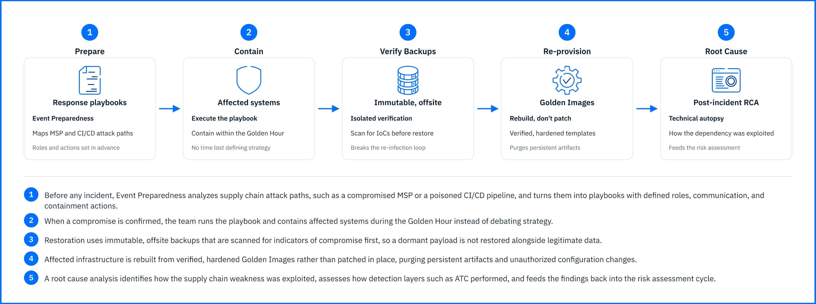

Incident Response and Recovery for Supply Chain Attacks
Even with the best preventative controls and advanced detection, you must assume attackers can still breach your supply chain. Robust incident response and recovery capabilities are therefore crucial to minimize damage, restore operations, and maintain trust. Because organizations often lack comprehensive visibility into the security posture of third-party vendors, incident response plans must incorporate a ‘trust but verify’ approach to continuously validate their security status.
Fig. 6. Recovering from a supply chain attack, from prepared playbooks to root cause analysis
Architectural Readiness and Response Playbooks
Resilience in the face of a supply chain compromise depends on the transition from ad-hoc troubleshooting to pre-defined, technical workflows. Because these attacks often leverage authorized administrative tunnels or signed software, the response must be meticulously prepared and regularly exercised.
Bitdefender Event Preparedness services provide the technical framework for developing these capabilities. By analyzing specific supply chain attack paths—such as a compromised Managed Service Provider (MSP) or a poisoned CI/CD pipeline—organizations can build step-by-step response playbooks. These playbooks outline specific roles, communication protocols, and containment actions, ensuring that SecOps teams act decisively rather than spending critical minutes during the "Golden Hour" of an incident defining their strategy.
Recovery via Verified Integrity and Secure Re-provisioning
Containment is only the first phase of the response lifecycle. The high-risk nature of supply chain attacks—where malware may be embedded in legitimate updates or hardware—requires a recovery process focused on comprehensive restoration to a verified state. Successful recovery depends on Isolated Backup Verification, where restoration utilizes immutable, offsite backups scanned for indicators of compromise (IoCs) before deployment. This technical gate prevents the "re-infection loop" where an attacker’s dormant payload is restored alongside legitimate data.
In the event of a compromised software delivery mechanism, Secure Re-provisioning through Golden Images is utilized because simply patching the existing environment is insufficient. Organizations utilize these verified, hardened system templates to re-provision affected infrastructure, guaranteeing that any persistent artifacts or unauthorized configuration changes introduced by the adversary are completely purged. Every incident must conclude with a rigorous Post-Incident Root Cause Analysis (RCA). This technical autopsy identifies how the supply chain vulnerability was exploited, assesses the performance of current detection layers like Advanced Threat Control (ATC), and feeds these insights back into the risk assessment cycle to harden the environment against similar vectors.
