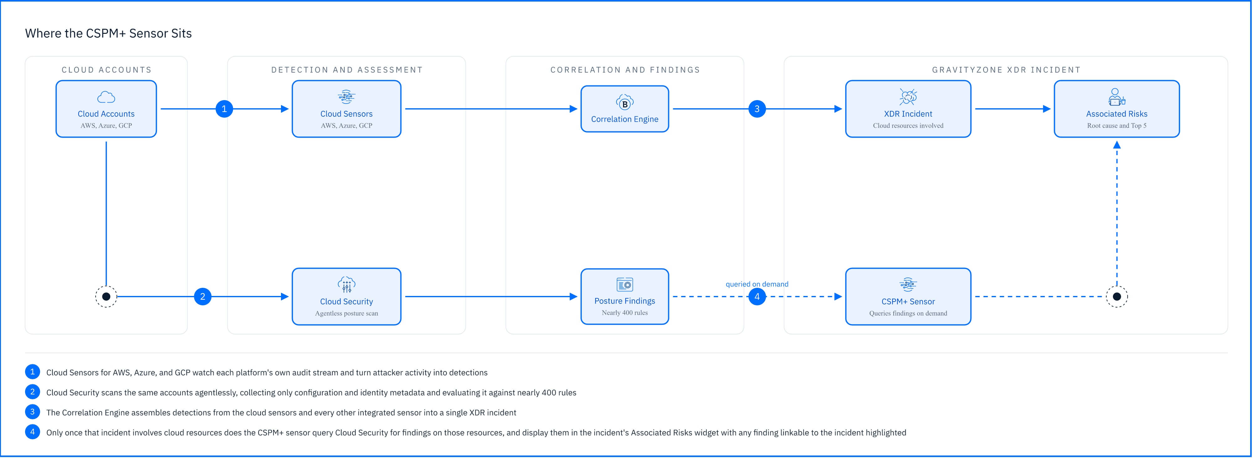

The CSPM+ sensor collects telemetry from your GravityZone Cloud Security instance and uses it to supply cloud platform posture context to GravityZone XDR incidents and to risk information. What it contributes is the configuration state surrounding the resources an attack touched: the standing conditions that made the resource reachable, rather than a record of what the attacker did.
That reverses the usual direction. A detection sensor pushes telemetry into the Correlation Engine; CSPM+ is queried by it. Once an incident involving cloud resources exists, the integration asks Cloud Security for findings on those resources and renders them in the Incident Advisor's Associated Risks widget, highlighting any finding that ties to the incident directly. It is enrichment applied after correlation, not an input to it.
Associated Risks Widget
Detection across those same environments is the job of the Cloud Sensors for AWS, Azure, and GCP, which do feed the Correlation Engine. Those sensors tell you an attacker deactivated logging or created access keys; CSPM+ tells you the account had no password policy and the role carried more permissions than it needed.

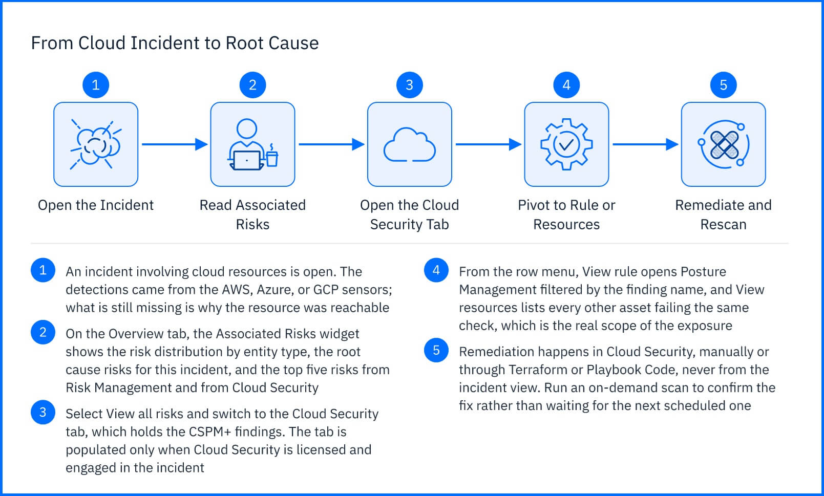

Tracing a Cloud Incident Back to the Rule That Allowed It
An incident involves an AWS or GCP identity and you want to know which configuration weakness made it possible. In the Associated Risks widget, look at Top 5 risks from Cloud Security for any finding highlighted as linked to the incident, then select View rule from its row menu. That opens Posture Management > Rules filtered to the finding, where Check Details give you the severity, the affected resources, and the remediation instructions. Nothing is fixed from the incident view: remediation, whether manual, Terraform, or Playbook Code, happens in Cloud Security.
Finding Every Other Resource Exposed by the Same Misconfiguration
One compromised resource almost never means one misconfigured resource. From the same row menu, select View resources instead. This pivots to Posture Management > Resources filtered by resource type and finding details, listing every other asset in the onboarded accounts that fails the same check. Treat that as the real scope: the incident named one resource, the pivot tells you how many more are waiting in the same condition. After remediating them, run an on-demand scan to confirm the fix rather than waiting for the next scheduled one.
