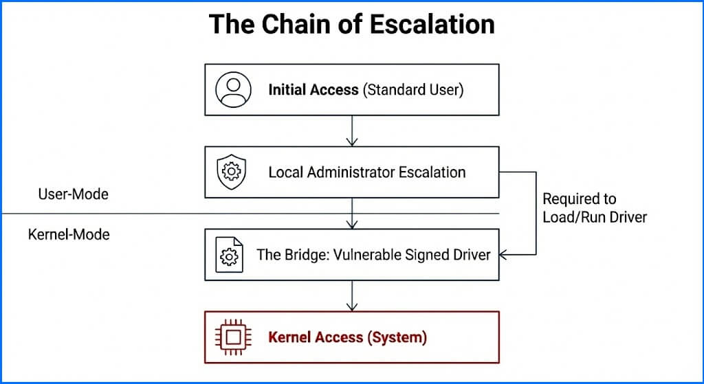

The Chain of Escalation
The use of BYOVD is typically the final stage in a multi-step chain of escalation. Attackers often begin their journey with a standard user account, gained through methods like phishing or credential theft. Because a standard user is heavily restricted by the operating system, the first objective is to escalate to a local administrator account. This transition allows the attacker to modify system settings and manage services, but it still limits them to User-Mode.
To tamper with endpoint security solutions, the attacker must bridge the gap between User-Mode and Kernel-Mode. Drivers serve as the primary bridge for this escalation, as they are the only components authorized to execute code within the kernel. Windows strictly limits the ability to load or unload device drivers to the SeLoadDriverPrivilege, which is reserved for Administrators and the System account. However, even as administrators, attackers cannot simply load their own custom malicious drivers because they lack a valid digital signature from a trusted authority.
To overcome this hurdle, attackers look for pre-existing, trusted drivers that are either vulnerable to exploitation or provide unsafe functionality by design. By "bringing" these legitimate drivers to the system and loading them using their administrator rights, they create a bridge to the kernel-mode. Once they are in the kernel, attackers have numerous options to directly attack the security agent and its monitoring capabilities.

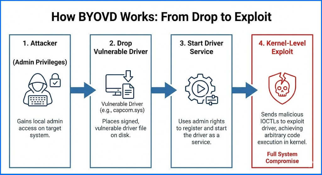

How BYOVD Works
The goal of a BYOVD attack is to gain kernel-mode privileges, often called Ring 0. At this level, code has unrestricted access to system memory and hardware. Since an attacker cannot load an unsigned malicious driver, they "bring" a driver signed by a reputable vendor (such as a hardware manufacturer or an old antivirus version) that has a known vulnerability.
  1. Initial Access and Elevation: The attacker first gains administrative rights on the target machine. While administrators have significant power, they still operate in user-mode. To move to the kernel, they must load a driver.
  2. Dropping the Driver: The attacker places a known vulnerable driver on the disk. These are often outdated versions of motherboard utilities, GPU tools, or diagnostic software.
  3. Loading the Driver: Using administrative privileges, the attacker installs and starts the driver service. Because the driver has a valid digital signature, Windows allows it to enter the kernel.
  4. Exploitation or Abuse: Once the driver is running in the kernel, the attacker sends Input/Output Control (IOCTL) commands to it. They either exploit a bug (like a buffer overflow) to execute shellcode, gain arbitrary memory access (read/write), or use "insecure by design" features to manipulate system memory.

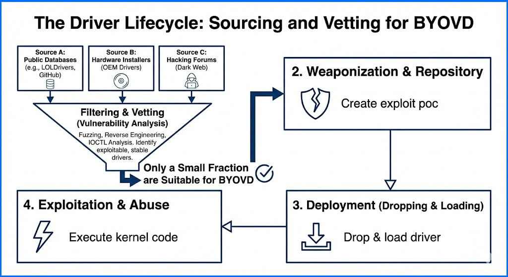

The Driver Lifecycle
The effectiveness of this technique relies on the attacker's ability to source the correct files. Not every driver is a candidate for BYOVD. For a driver to be useful, it must allow a user-mode application to trigger a kernel-mode action exceeding its intended scope.
Threat actors find these drivers through proactive methods. They monitor public security research and databases like "LOLDrivers," which catalog signed drivers known to be abusable. They also perform "driver hunting" by scanning large volumes of legitimate software installers from hardware vendors for common IOCTL vulnerabilities. Once a driver is identified, it is added to a repository of pre-signed exploits.
Attackers often prefer legacy drivers from the 2013 to 2016 era because they lack modern security features like Control Flow Guard (CFG), making them easier to exploit. Simultaneously, they scan brand new software releases, as newly discovered drivers are highly valuable because they are not yet included in any blocklists, providing a window of opportunity before security vendors can react.
Beyond abusing legitimate drivers, Bitdefender Labs has investigated cases involving purposefully designed malicious drivers. In these scenarios, threat actors develop custom malware from the ground up to operate specifically within the kernel. To bypass certification requirements, they use stolen digital certificates obtained from legitimate vendors who have suffered data breaches. In these instances, the primary remediation is for the certificate authority to revoke the stolen certificate entirely, rather than adding individual driver hashes to a blocklist.

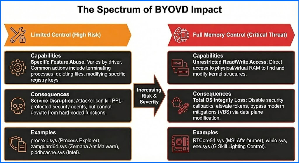

The Spectrum of BYOVD Impact
Since you’ve learned the mechanics of how a driver is targeted (bugs vs. design), we can now analyze what the consequences are. BYOVD is a generic term that covers a variety of scenarios. The potential for damage depends entirely on the specific capabilities of the driver being abused. These capabilities generally fall into two categories.
Limited Control
The first category involves drivers that expose specific features that don’t offer full memory access, but provide functionality that serves the attacker's needs. For example, a driver (such as procexp.sys for Process Explorer) might include a legitimate function to terminate system processes. While this is useful for diagnostic tools, an attacker can use it to kill the security agent's process. This is the less severe form of BYOVD impact because the attacker is limited to the specific functions the developer included in the driver.
Antimalware and antirootkit tools, such as the Zemana AntiMalware (ZAM) driver, deserves a special mention. Unlike hardware drivers, these are designed for disinfection and must expose kernel-level functions to terminate processes or delete files. Threat actors use tools like Terminator to abuse these IOCTLs, which often ignore Protected Process Light (PPL) flags that normally safeguard security agents. By using these specialized drivers, an attacker can kill an EDR agent even when standard administrative tools would be blocked.
Full Memory Control
The second, more dangerous category includes drivers that provide unrestricted access to kernel memory. These are often hardware-related drivers designed to allow low-level system configuration. When abused, they allow an attacker to read from or write to any part of the system's RAM.
This is significantly worse than targeted feature abuse because protecting every single bit of the system's memory is nearly impossible. There are billions of critical memory bits, many of which are poorly documented or change dynamically. By modifying a few bytes, attackers can disable security callbacks, elevate their own process tokens, or hide malicious artifacts. Because these modifications occur in the data plane rather than the execution plane, they are nearly impossible to block without a massive, system-wide performance penalty. Once an attacker has full memory control, the operating system's integrity is effectively non-existent.
You might be surprised why the arbitrary code execution is not ranked as high as the read/write access to the memory. Unrestricted memory access is technically more dangerous and difficult to defend against in a modern Windows environment. Microsoft has introduced effective hardware-based mitigations to stop code execution, such as Virtualization-Based Security (VBS) or HVCI (HyperVisor-protected Code Integrity), which make it difficult for an attacker to inject and run new code in the kernel.
