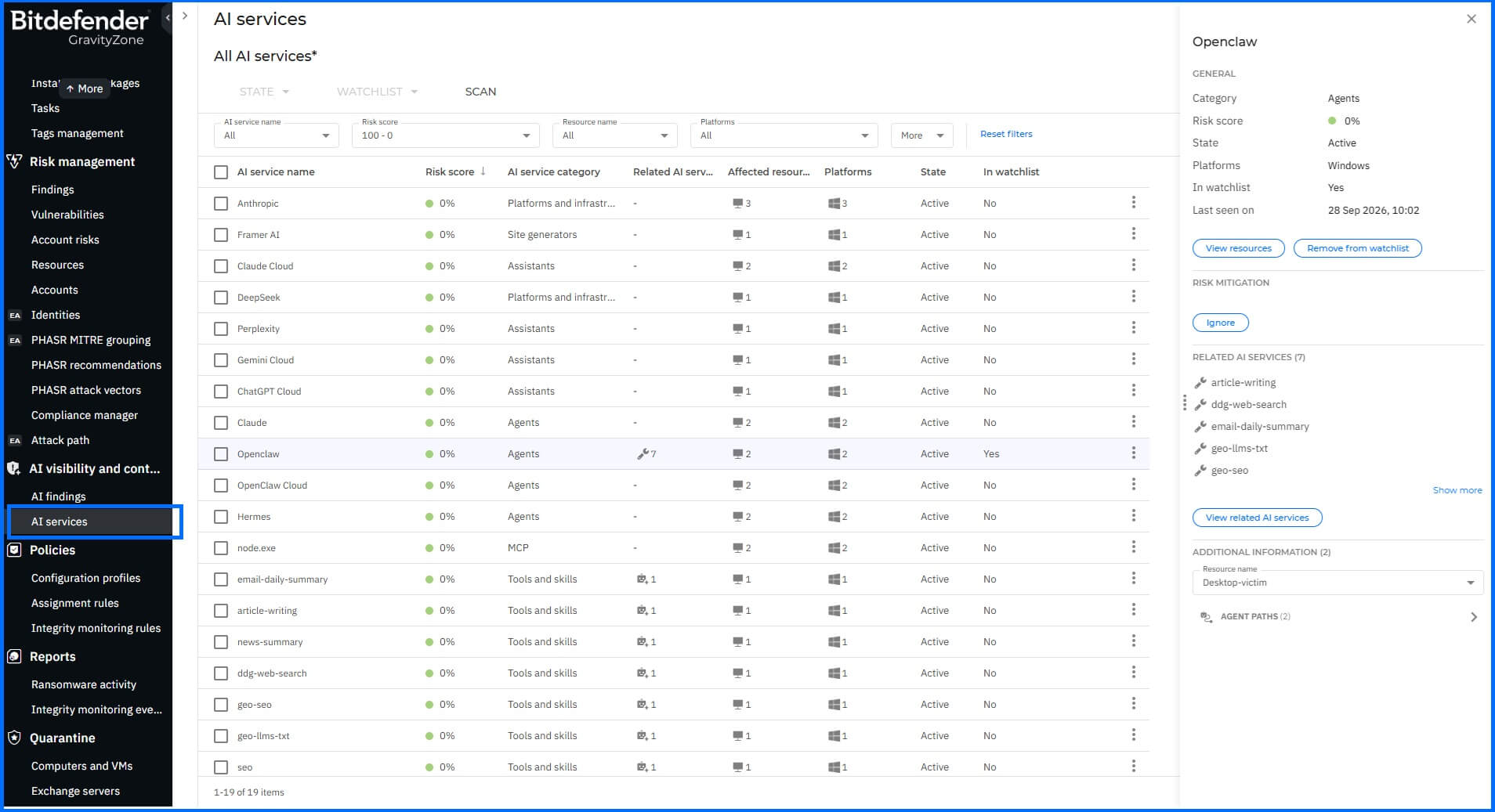

AI Services answers “what AI is running in my environment?” It is the inventory: every discovered service with its risk score, its function category, the related AI assets it depends on or exposes, the number of open findings, the affected resources it was found on, the endpoints it runs on, its state (Active or Ignored), and whether it sits on the watchlist. Filters and predefined views narrow it. Opening a service shows its details along with mitigation guidance for the risks associated with it.

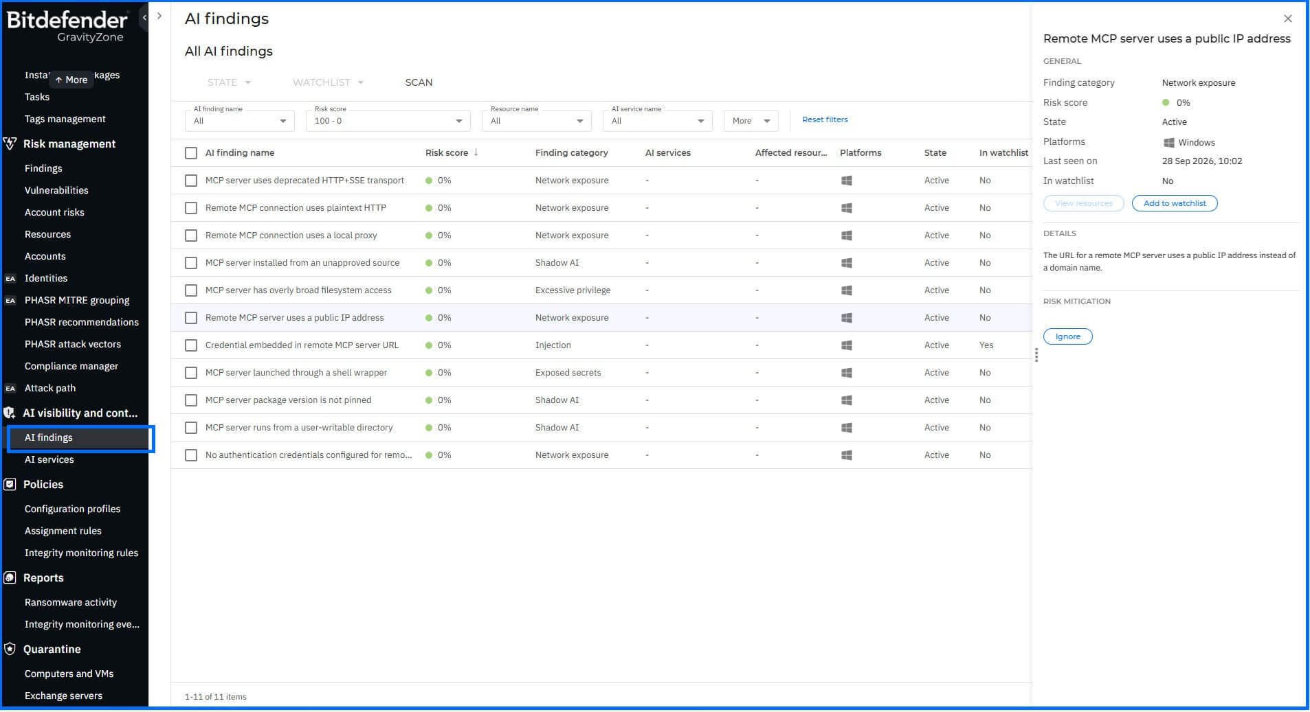

AI Findings answers “what should I look at first?” It is the prioritized risk view: each finding carries a risk score, the AI service it relates to, and the affected resources it was observed on. Each finding links to mitigation guidance and to the endpoint-specific evidence behind it, so an administrator can see why a finding was raised on one machine and not another before deciding what to do about it.
AI Visibility and Control on the ASM Dashboard answers “how exposed is the organization to AI, and where is that exposure concentrated?” The dedicated smart view under Monitoring > ASM Dashboard summarizes AI usage and risk across the organization: its widgets show the overall AI risk posture, compare risk across AI categories, list the affected users and endpoints, break findings down by AI category, and list the discovered AI services. AIVC widgets can also be added to custom dashboard smart views, so AI exposure can sit on the same dashboard as the rest of your attack surface.
AI findings also appear in Risk Management > Resources, next to each endpoint’s other risk data. From an affected endpoint, you can move to its AI findings and on to the AI services behind them, so AI exposure is assessed together with misconfigurations and vulnerabilities on the same machine, not in a separate report.
Most administrators will work in AI Findings day to day and drop into AI Services when they need the full picture of a particular tool, and use the ASM Dashboard view when reporting AI exposure to management. Review AI Services against your list of sanctioned tools, not just AI Findings. A tool can have no findings and still not be one your organization approved.
For SOC analysts: AI Findings carry endpoint-specific evidence, which makes them usable as an investigation starting point rather than only as a posture metric. A finding tied to a local model runtime or an MCP server identifies a process executing on a specific host outside the browser sandbox, and the affected-resources list gives the host set to pivot from in Search (the telemetry query view) and Incident Advisor.

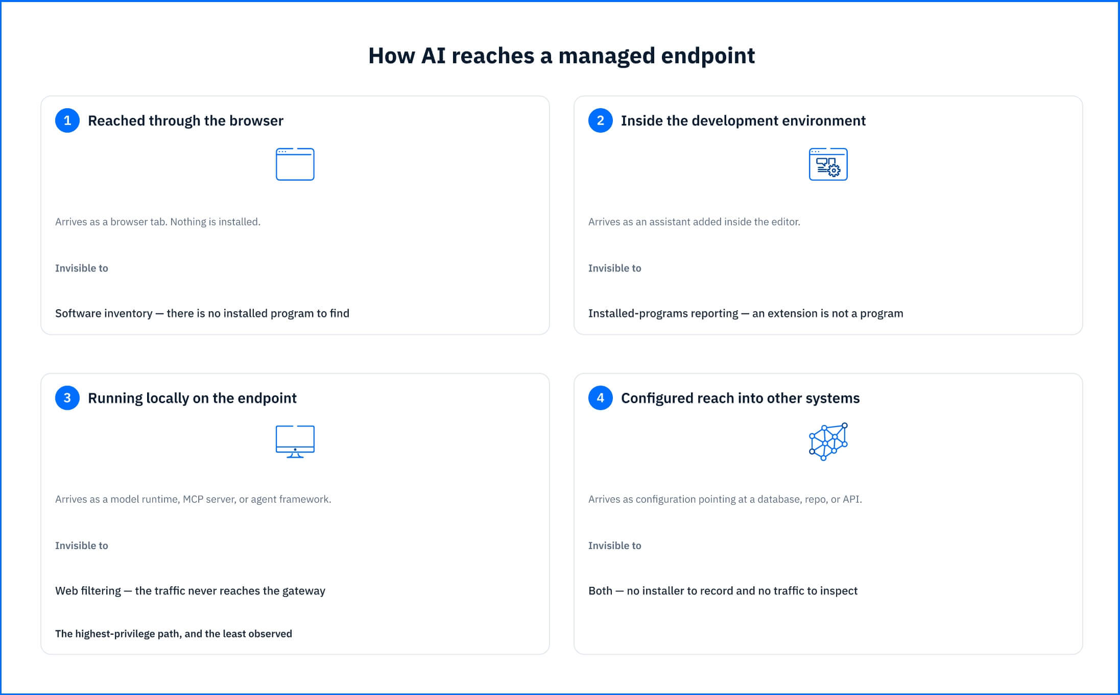

AI reaches your endpoints through paths your software inventory was never built to watch. The inventory covers four classes of exposure, each of which sits outside a control you already own.
Fig. 1. Four paths AI takes onto a managed endpoint, and the control that cannot see each one
AI services reached through the browser
Hosted assistants are the path most organizations already worry about. The inventory shows which ones are in use, on which machines, and whether you have marked them as approved, so a filtering decision starts from what your users actually run rather than from a list of well-known domains.
AI inside the development environment
Coding assistants run inside editors that already hold source repositories, and often credentials and configuration files in the same working directory. They are rarely covered by whatever you decided about chat assistants, because nobody classified them as the same kind of tool.
AI running locally on the endpoint
Local model runtimes, MCP servers, and agent frameworks execute on the machine itself. A control that governs which websites an endpoint may reach does not see them at all. The MCP server is the sharpest case: its entire purpose is to hand a model access to something else, and it usually arrives as a configuration entry rather than as an install.
AI with reach into other systems
Where an AI tool is configured to connect to a database, a code repository, an internal API, or a third-party model service, that connection is part of your attack surface. AI Visibility and Control records the configured scope of those connections, not the data moving across them.

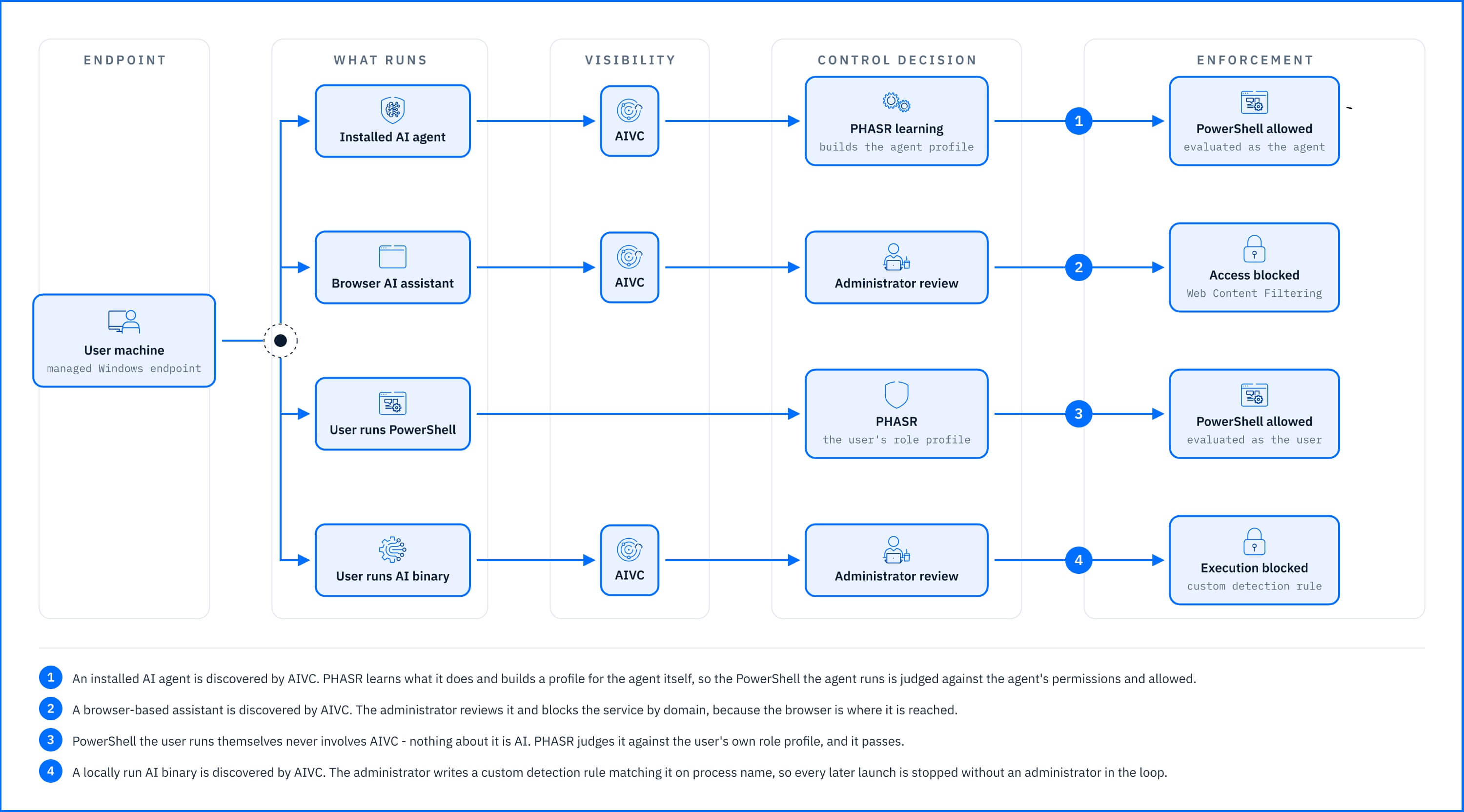

From AIVC visibility to enforcement: Hardening and blocking
Fig. 2. One endpoint, four paths: what AIVC discovers, what the administrator decides, and which control enforces it
AIVC establishes what AI is present and what about it is risky. It does not block access, does not remove software, and does not change what a running program is allowed to do. Those are separate jobs handled by controls already in the Bitdefender GravityZone console.
  • Blocking access to an AI service the organization prohibits you can configure in Web Content Filtering. Most AI services are reached through the browser, so once AIVC identifies which ones are in use, Web Content Filtering can block the domains.
  • Blocking a specific tool wherever it turns up is what Custom detection rules do. Once AIVC has named the tool, you can define a rule that matches it, on process name for instance, and attach Kill process as an automatic action, so every later appearance is handled without an administrator in the loop. A rule can target the whole company or only endpoints carrying a given tag.
  • Reducing what an installed tool is permitted to do on the endpoint belongs to hardening policies and to PHASR. PHASR for AI agents evaluates the agent separately from the person using the machine: processes started by a known agent binary are attributed to that agent's own behavioral profile rather than to the user's session. The agent is allowed the tools its tasks require, while the user's restrictions stay tied to the user's role.

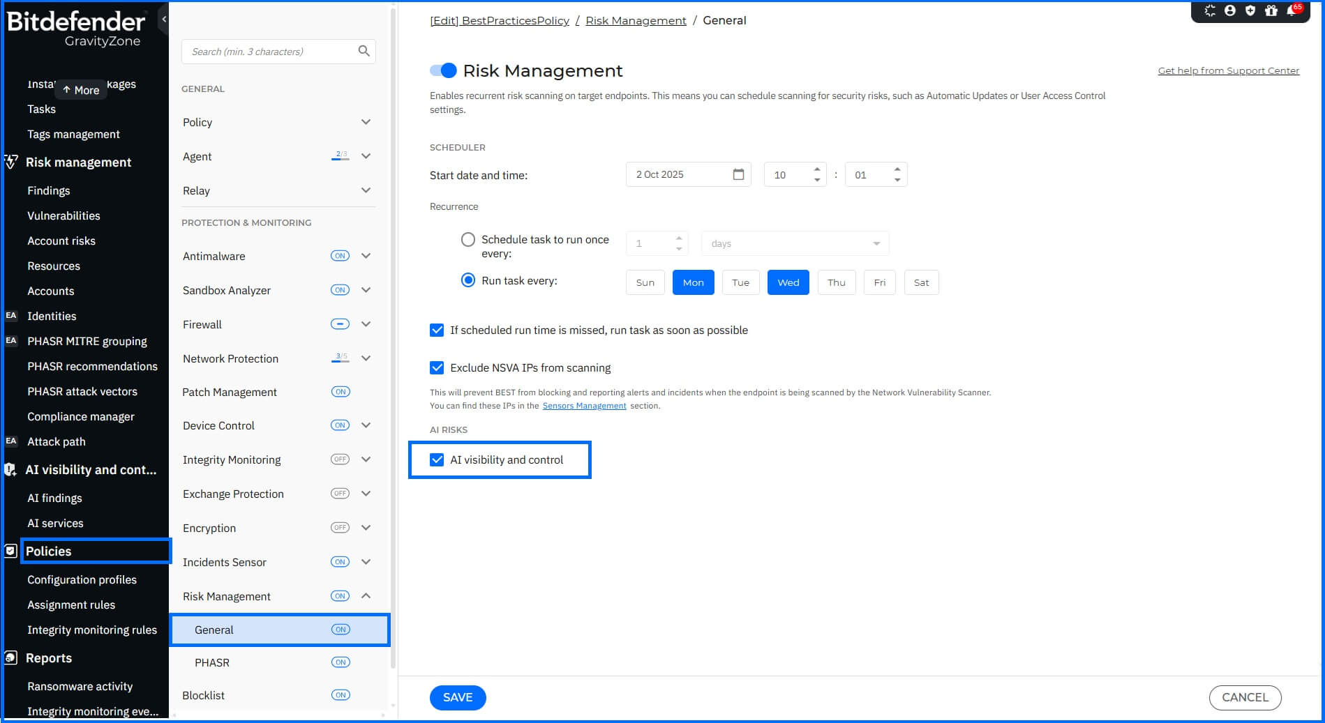

Deployment and Configuration
There is nothing new to deploy. AI Visibility and Control runs on the Bitdefender Endpoint Security Tools (BEST) agent you already have, so coverage does not depend on a rollout project. You turn it on by editing an existing policy: the setting sits in the General section of Risk Management, and it applies to whatever endpoints that policy already targets. Results appear after the next risk scan on those endpoints.
Full configuration detail is on the Bitdefender Support Center.

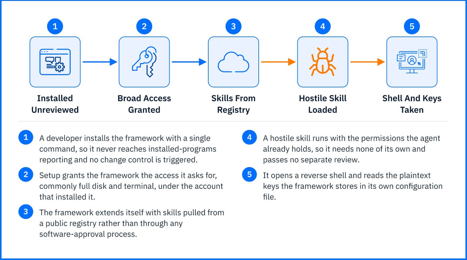

A developer installs OpenClaw, an open-source framework for AI agents that act on the operating system rather than only answering questions. It arrives as a single-line install command, so it never appears in installed-programs reporting, and it runs with whatever the user granted during setup, often full disk and terminal access. It appears in AI Services under Tools and skills with a risk score, and the finding lists the hosts it was observed on.
What matters is not the framework but what it loads. OpenClaw extends itself with skills, code packages pulled from ClawHub, a public registry, and a malicious skill inherits the permissions the agent already holds. Bitdefender has documented skills that open reverse shells and exfiltrate the plain-text API keys OpenClaw stores in its own configuration file.
From the affected-host set you can confirm scope in Live Search. This is one of the cases where the inventory leads to removal rather than tuning: Bitdefender's guidance is not to run OpenClaw on company devices. Where it is still running, PHASR hardens the workstation by blocking at the level of individual actions rather than whole programs, so the agent can be stopped from decoding obfuscated commands, terminating processes, or making silent outbound transfers while it continues to run.
